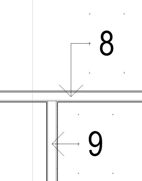

What I did discover is that increasing the junction property of the leg of the 'T' from 8 to 9 whilst leaving the long arm at 8, removes the plasterboard in the junction. It is not perfect because it still leaves a line. I've attached a screen shot. What am I missing here?
