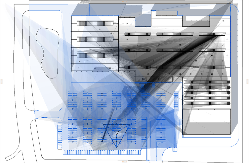

Something related. I've run into a very annoying exprience during creating a 3d document. Some surfaces were rendered weird and the shadows also. Then I applied the changes in the registry to RenderingAPI and DrawShadowsDuringNavigationOGL what MASz suggested. It solved the problem. See the attached screenshots. Thank you MASz!AC27default.pngAC27modified.png
