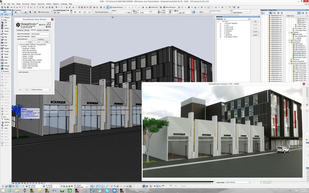

Daniel Ward
Hi Steve,
the Maxwell Plug in for ArchiCAD is essentially a more sophisticated version of the Artlantis Plug-in for ArchiCAD, with the added feature of being able to get a preview render and being able to tell the Exported File what ArchiCAD materials to link to Maxwell materials when the file is opened in Maxwell.
The Octane plug-in works directly inside of ArchiCAD, at no point do you exit ArchiCAD when you're using it, just like CineRender. So looking at the screen capture below you can see that I have the Octane plug-in running in ArchiCAD and I can still select and edit the ArchiCAD elements. Further you can see that I can select a ArchiCAD object in the ArchiCAD 3D window, I can nominate it as an Octane Proxy Object and browse to an Xfrog .obj high polygon tree object, and that object is the one that gets rendered in the Octane Rendering Viewport. If I navigate in the ArchiCAD 3D Window, the Octane View Port updates accordingly. If I change the ArchiCAD sun setting, the change is reflected in the Octane View Port. If I change any of the ArchiCAD geometry and update the Octane View Port I see the change straight away. You get the idea I'm sure.
All of this is getting rendered in real time off the GPU's you have installed in your PC, the more you have, the faster it goes. ArchiCAD uses which ever of the GPU's you have installed that is identified as the primary device by the system. The ArchiCAD 3D window runs pretty slowly, even in ArchiCAD 19 unless you pause the Octane Rendering process, or you tell the Octane Plug-in not to use one of your installed GPU's.
I wouldn't bother with an Quadro card for ArchiCAD, Octane or even Maxwell for that matter. ArchiCAD won't take advantage of it and the GTX series of Nvidia cards will give you a lot more CUDA cores for Octane or Maxwell rendering for your money.
Any away, whether you stick with Maxwell, or give Octane a try, you'll definitely appreciate a new GPU, you'll notice a huge speed improvement for sure. šŸ˜‰
