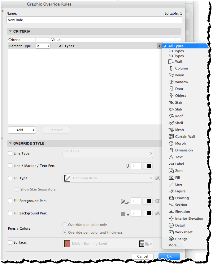

Zoltan wrote:
2. Can we get detailed information about working of Graphic Override function? What kind of criteria can be use? Can we use criteria for 2D or 3D element allowed only?
Graphics Overrides are remarkably powerful for quickly generating alternative presentations of live model views. Yes, 2D or 3D elements - screenshot of list of element types...

...and screenshot of Criteria types (partial - cannot expand them all for one screenshot - but you get the idea of how powerful this can be!)...
