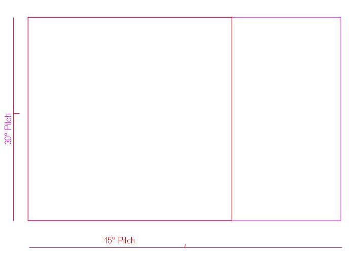

Ok,
following are a couple of snap shots of what I'm after.
The first is showing with two roof in plan what I trying to do with one roof and not using the mesh tool.
