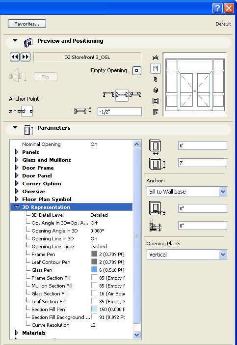

I looked at this object with the default settings except for Opening Line in 3D: and Opening Line Type and the opening lines are correct (they meet on the hinged side of the door). Is your door correct with the default settings?

Works fine here (see attached image). My Object Library 10.lcf is dated 9/05/2006. Some other countries use the reverse symbol (lines meet at the handle side, not the hinge side), so maybe you have a non-US library (I don't know how that would happen).

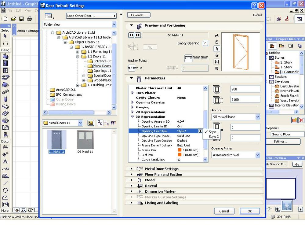

I have INT, but should there not be a parameter to choose the opening line type?
I believe the issue is not the line type, but the relationship of the 3d opening lines and the hinge side of the door (as illustrated below with double doors).

Ahh -- USA version does not have a parameter for "Opening Line Style".
