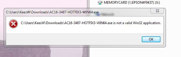

I tried loading the upgrade and got the following error message. Now what?
