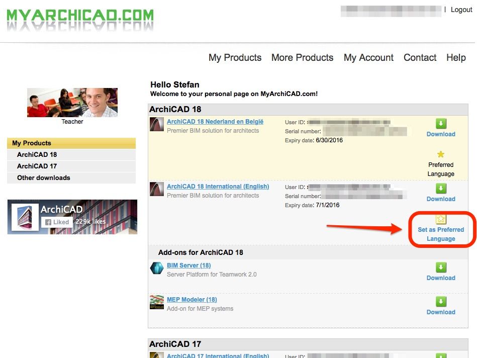

At the MyArchicad.com site, if you have been there in the past, you should see a screen such as the one I see in the attachment. Click the 'Try new ArchiCAD version now' button to add it to your downloads list. None of us understand why this doesn't just happen automatically. I imagine you should see the INT version even if the Italian version is not ready...?

You can also change your profile itself. Then you can access the INT version and set that as the preferred version. After that, you can revert back to the regional version.
