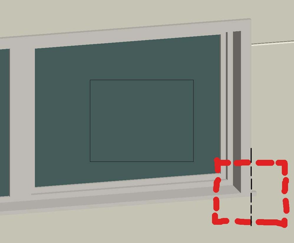

I've tried to align the sill with the vertical closure (like shown in the attached image), but I didn't manage to do that. Could you help me?
Thank you.

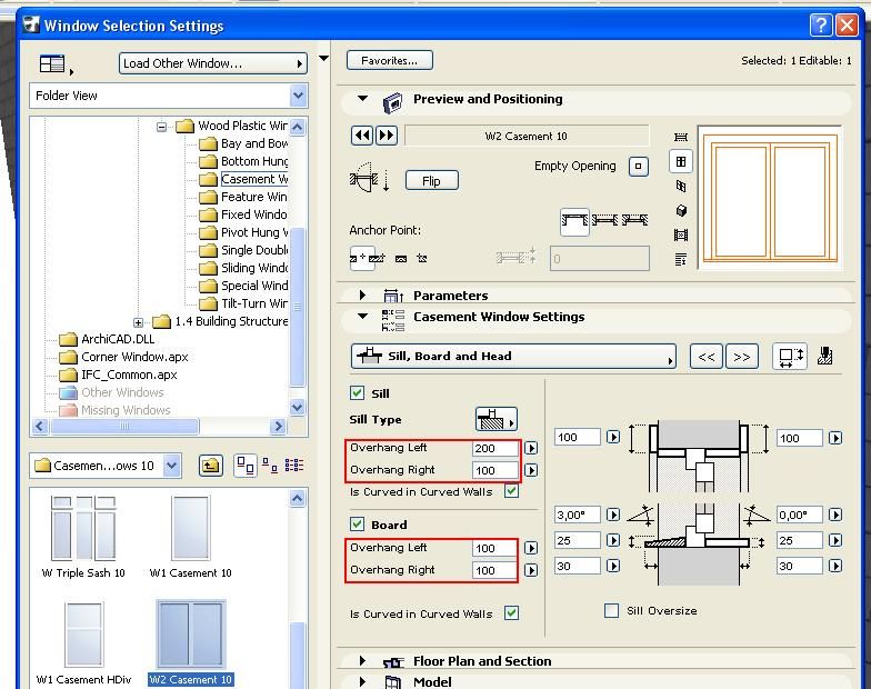

try overhang parameters in window setting
I've already tried that ... it seems that the sill continues to mantain that distance from the vertical closure, no matter what values I assign to overhang parameters. Maybe it's a bug.
Thank you for the suggestion.
I just did it in my project and I adjusted the sill over hang through the Parameters then brick molding, sill and... then toward the bottom (sill overhang side) I had mine at 2" and it was overhanging and changed it to 0" and it changed.
