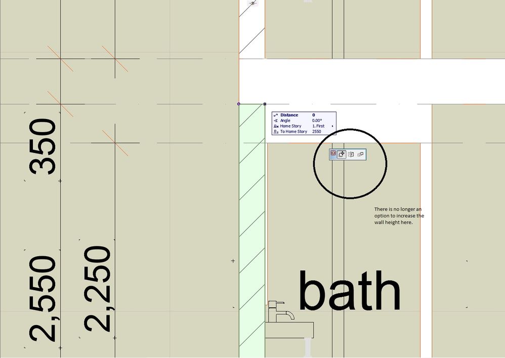

Our office recently updated to archicad 19 and we are finding that we can no longer manually increase wall heights in section. Is this a glitch or is there a setting I need to adjust?

Hi Walter
This was an issue when 19 first came out and seems to have been fixed. If you haven't installed the latest update I would recomend trying that.
http://www.graphisoft.com/downloads/archicad/updates/AC19/AC19-4013to5005-ReleaseNotes.html
It could also be because your selected wall is part of a group, so not all pet palette options are available. Suspend groups then adjust height.
I tried suspending the groups, but had no luck. Will try downloading the update and go from there.
