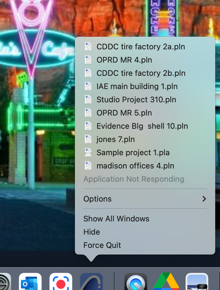

So, I just put a file on my desktop and tried to open it, but I get the same issue.  Archicad 26 has full disc access and also appears in the Files and Folders.  When I go to Force Quit, I get this image.  Not sure if this is normally what it looks like.

Edit: PS Yes, what you see with option-right-click is correct/normal.  All apps list their recent files, then app specific menu options, etc as you see.
