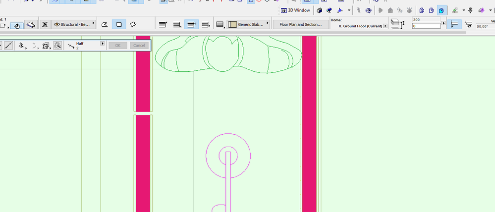

I'm not sure how I can attach one wall to another wall. If I have two walls lined up as in the attached image, I know how to "Adjust" or "Extend" the top wall segment down to the lower wall segment, but they still wont attach or combine; they are still two distinct wall segments.
I want it to become one wall segment.
Any pointers as to how I can do this?

There is a "Merge Walls" command in the EDIT > RESHAPE menu, but this will create a new complex profile from the merged walls.
However all you need to do is then switch it back to be a composite type wall.

No you need to select both walls and then EDIT menu > Reshape > Merge Walls.
😉, thank you; that worked.
