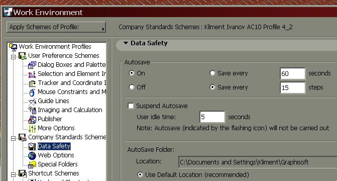

With Autosave "On" when AC saves files, it makes a back-up file, with extension .bpn. Open the .bpn file and you will get your crashed file with 15 steps lost.
No need to rename anything! Old AutoCad habits die hard! 😉

.bpn files are creating when hit Save, as long as you have 'Make a Backup Copy' checked under Data Safety in the WE.
The Autosave will save (as long as it you remain idle long enough for the bulldozer to disappear from your status bar) to a file called @Global.T. This file is saved to the AutoSave folder as set in the same Data Saftey dialog. On my PC the @Global.T file is stored at C:\Documents and Settings\Link\Graphisoft\ArchiCAD AutoSave Folder.
This file will exist as long as ArchiCAD is open and an AutoSave has had a chance to save. If ArchiCAD closes correctly it is automatically deleted. If ArchiCAD crashes, it remains there and ArchiCAD will look for it upon opening. When it finds it, we're prompted with the 'ArchiCAD Project Recovery' dialog which asks if we want to open that file or delete it.
At any time the @Global.T file is there, it can be renamed with a .pln extension and opened like a regular file.
