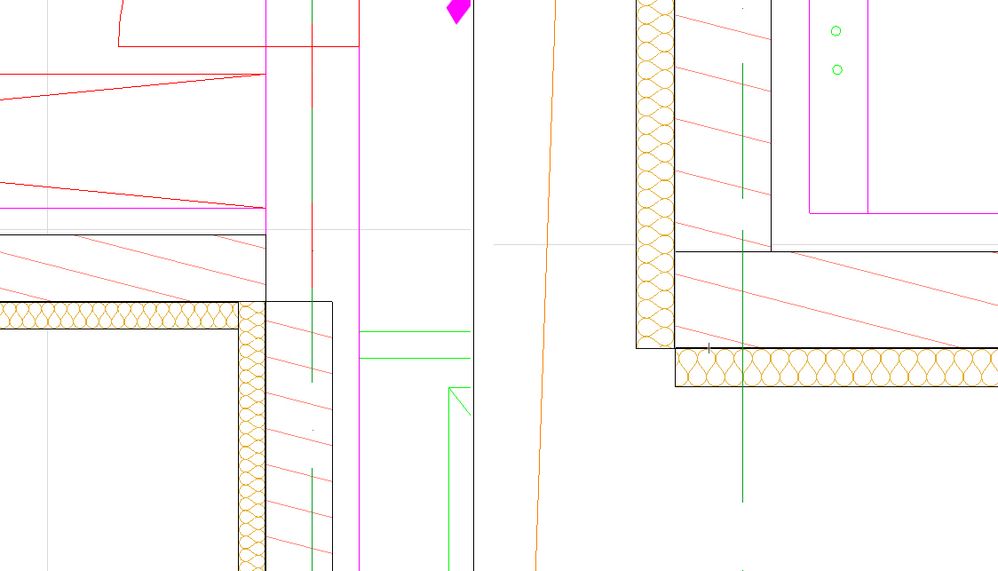

I am working in Archicad 17 and I have a problem with the wall connection display in floorplan view, I have attached an image.
I need it to display like it's connected cause I cannot use the drawings in production this way.
Hope you can help.
Thank you!
1 REPLY 1
As the first step make sure the Reference Lines of your Walls are properly connected. Select the two Walls that should connect and use the Intersect command. That should make them form a proper L-joint.
