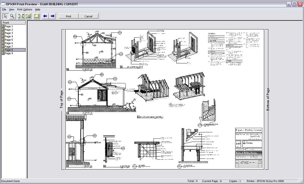

Back in 9.0 With plotmaker When I selected a full job set of drawings plotmaker would print the lot unattended.
In V10 and V11 I have never been able to work out how to get this function working.
You can see in the screenshot from plotmaker the list of drawings ready to print.
In 10/11 all I have is just 1 drawing at a time, which requires me to actively select and hit print.
It doesn't seem logical that I should not be able to do this.
My printer is an Epsom 4800
Are others out there able to batch print a full job.

rjwilden
Ill try and explain
You can see in the attached image that I have published the whole set.Yet in the printer preview down the side there is only one page listed not the 15 there should be. So I hit print and the page will print. Then another print preview page comes up and I hit print and this will print and so forth until you have printed all 15 .
Now thats OK If you haven't got anything better to do with your time.
Of coarse that not the only problem as you can see the drawing scale is all wrong in the attached image. This Page is an A2. THis happens when I select too many drawings. Some will end up looking like the screen shot.
I know that this is a Archicad problem and not a printer problem because I selected a multipage PDF and it printed correctly ie it displayed a list of drawings in the preview window not just one.

__archiben
ok. i was on the right track.
and i do still think this is a printer problem, not archicad's:
your PDF example isn't the same situation as archicad's publisher. printing a multi-page PDF is still only one print job. archicad's publisher sends each selected layout to the print queue as individual print jobs. one per layout.
also, the fact that they are getting to the printer means it's not archicad at fault. the question really is what the epson print monitor thing is doing popping up all the time . . . that is where i would lay the blame!
