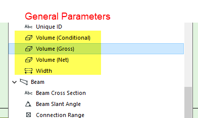

Where are you trying to use it?
For labels and schedules you can just use the volumes in 'General Parameters'.
It seems these 'General' volumes are used for all (most) elements now except for column core and column veneer volumes.

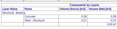

Just use component schedule

‎2023-02-03 01:13 PM
In a component schedule you can use 'Component Volume'.
At the moment though I can't see how you can tell which Building Material it is for though.
I can only list all of the building materials.

‎2023-02-03 04:06 PM
All good now.
You have to add the 'Name' from the Building Material list and not 'Building Materials' from the General list.
