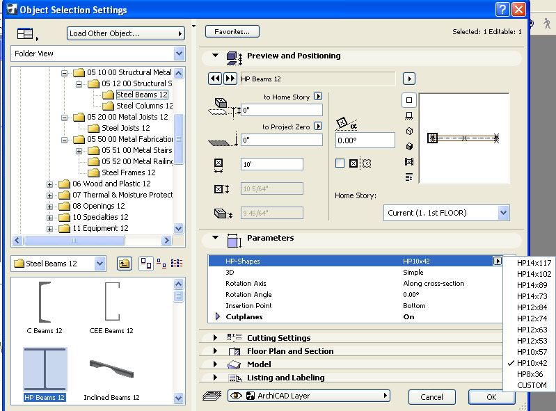

I want to be able to use the beam and column tool and have the standard AISC steel dimensions shapes menu. I don't see it when I go to the settings dialog box, except for the complex structure box which provides the shape. I want to be able to select from a list of structural members (W12x14, C8.5x11, WT3x4, etc). I can't seem to figure this out. The only way I can find them is through the object tool. I don't want to use the object tool, I want to be able to use the beam and column tool.

In the US library you have the standard AISC steel sizes as library parts. See screenshot.
If you want to apply AISC sizes to custom profiles

Then you can use the following method to bring the sizes into the custom profile editor.

Thank you for explaining that w/ the profile editor. That works, but seems to be too much work.
I could use the library, but why is there a beam tool if you can't use AISC standard beams? That seems to be negating the purpose of the beam and column tool. I don't want to have to go into the library every time to find the beam I want. Why isn't there a pull down menu from the Beam and column command for standard steel sizes?

This is a reasonable wish/request I think. Why indeed can we not have a more sophisticated beam/column tool? History tells us why we are where we are today. But, a new user cares little for history - only performance, and the old GS motto of "works the way you do".
Building up a library of profiles for the beam and column tool is a partial solution - but as noted in old wishes, there is no hierarchy (folder structure) to help the user when hundreds of profiles are present. It is a "version 1" feature that has never made it to "version 2".
But, iver, if you study the steel objects, you'll discover a remarkable amount of intelligence that just does not exist for the beam (or column) tool, even with profiles, not the least of which is the various cutting options for each end of the beam. It was easier for GS to provide these intelligent objects than to add major new features to the tool. I guess I got myself back to history/reality...
