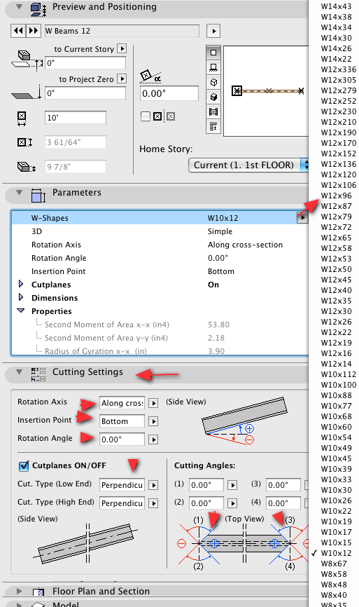

In the US library you have the standard AISC steel sizes as library parts. See screenshot.
If you want to apply AISC sizes to custom profiles

Then you can use the following method to bring the sizes into the custom profile editor.
[still not sure why the library won't do for what you want; it would be interesting to know why if you don't mind sharing]
