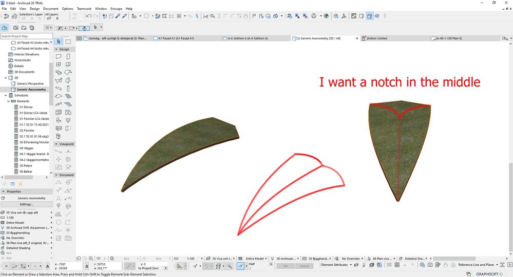

I want to make some curvy shapes on a roof.
Round shapes from above (I've succeeded in that).
But from the side I want to bend the roof so that it bends down in a round shape (I haven't managed to do that myself).
I also want to put the pieces together into one, since there are currently two of them. Does it work?

Yes exactly! That's what I meant from the beginning. "Curved in only one direction"
Maybe it wasn't so clearly described in my first picture.

Hi, for that one you need to construct your shell by extrusion.

Then I have finally succeeded in what I wanted from the beginning!
What I didn't tell you at the beginning, and that I "might want to do" is a cut down the middle.
BrunoH
 Something like that ?
