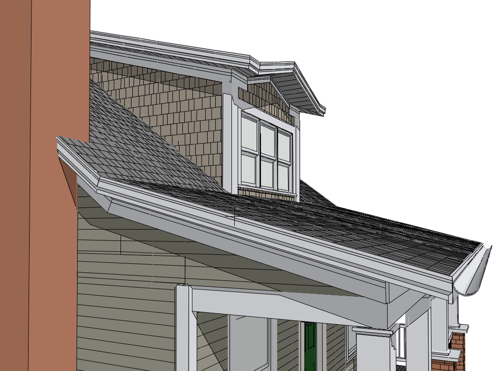

Rick Thompson
I guess you could apply a thin rafter object (or 2) to the eave. With those you have more end flexibility. If you need to join different roof pitches, this is a great object and worth the $.
Or, tell your boss working with cropping beams will take more time than the 3D library cost:) It does come with a lot of useful objects.
