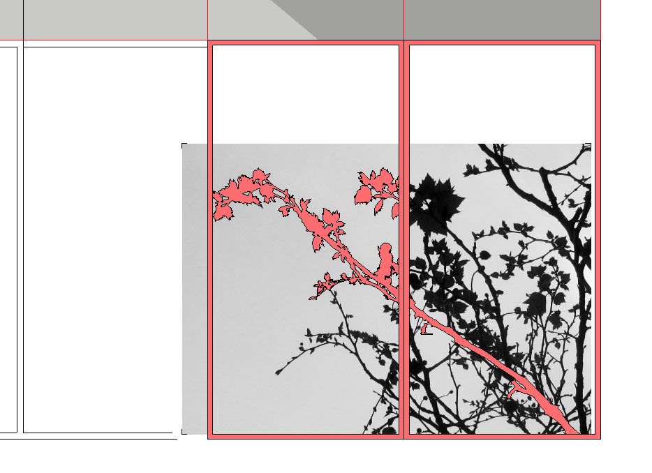

Attached below is another example of a screen Im creating
I have noticed you cant magic wand a complete section of polylines into a slab without basically dividing it up into a grid then I can combine them all together adding to the slab selection and magic wanding togther back into the more complex shape.

The other screen (tree branches) however is not modular im spending forever tracing around individual branches with slabs and this is a very time consuming method (what have i got myself in for here) especially as im intending each screen to be a unique pattern.
I suppose there is no need to unify the slabs together until i finish each screen they can remain in gridline sections of simpler slab geometry until which time i can convert all the final slabs into a single morph for each individual screen
if only there was a way for archicad to convert a jpg or image into lines i tried exploding but this has no effect im not sure if vector images such as a png are able to be exploded in archicad into lines?
or perhaps an image to dwg converter of some type
If primarily for presentation, it seems like a transparent image with an alpha channel mask would be the way to go. http://archicad-talk.graphisoft.com/viewtopic.php?t=5304 as an example.

Thanks for that, this seems like it would be the best option so far, it is also far easier to use an existing image and play around with it in photoshop, than have to retrace the whole thing in archicad, although I do find working in cad far more accurate.
Im guessing I wont want to get too close in the rendering/movie presentation as the flat bitmap effect or pixelated edges might become a little more obvious.
right now I have to remember how to work the alpha channel masks in photoshop it has been a while since i have had a play with it.
