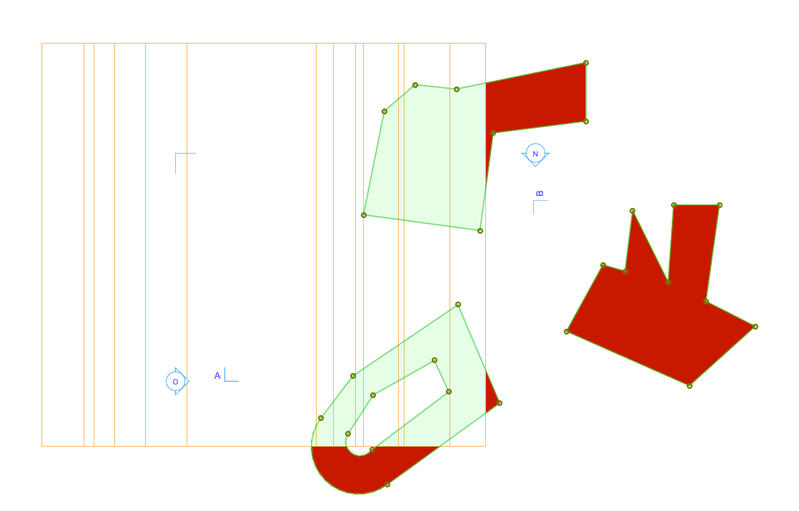

What I am trying to do: Say you have your GIS 2D map with all your roads, grasslands, water and other features and everything is neatly combined in groups. I want to make meshes/slabs out of them and then with solid element operations to substract/add them from a terrain mesh. This requires ofc to turn all these elements into something solid first.
Problem is, you can't turn them into a solid all at once but you have to select them one by one. Even worse, if the element is making a loop (say, a road that encircles a grass field), then the selection will create an area including the inner one, resultling in having to substract the inner area afterwards

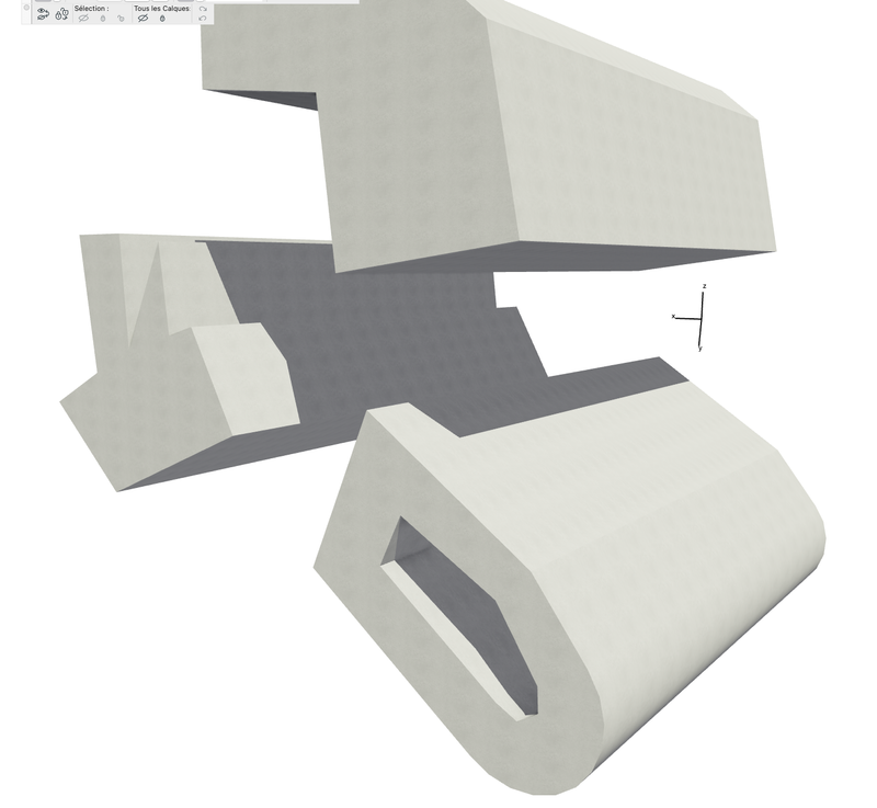

To help you can use the Profiler Add-On witch is in the Goodies suite.
Select a group of Fills, Extrude them with the Add-On will create a 3D object on plan but oriented horizontally.
You can then convert this object to Form and Rotate and Move it to the right position.
