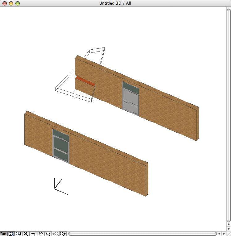

I'm surprised that I have not seen this yet. Perhaps it has been posted and I just missed it. There is a definite bug with the Storefront doors and a SEO wall. The door looses the glass definition in the door panel, but not in the transom. Delete the operator and the glass returns.

I reported this bug for other windows during beta. Guess they must have missed this one!

Actually this bug exists for other objects that have their section properties decided by the object.
I have a footing beam that has a wall in the edge rebate. the section fill of the wall is controlled by a parameter, the fill of the beam by the default fill of the object. If I apply an operator to the object the fill in the wall changes to teh default fill.
