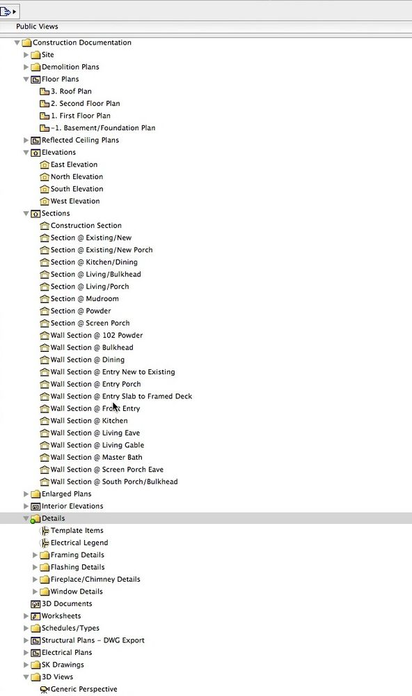

I just learned about clone folders in the past year, and they can be very useful for SOME applications. For example, lets say you want to create a folder for all your interior elevations. By creating a clone folder, all the interiors, even the ones you add later, will automatically go from the project map to the view map into the new clone folder.
You can create layer combinations, pen sets, model view options, etc. specific to the interior elevations and set that setting once at the clone folder level. Any new interiors you create will be added to that folder with all the correct settings. This eliminates the problem of forgetting to drag "stuff" over from the project map to the view map.
I do not find this useful for the details. I like to group my details into folders like "framing details", "flashing details", "fireplace details" etc. By having a clone folder, it puts all the details into that one folder, and it gets hard to navigate efficiently.
A few words of caution: if you delete something from a clone folder it deletes the whole clone folder. It's not hard to recreate, but can be annoying.
An image of my view map showing clone folders and non-clones (note the different icons).

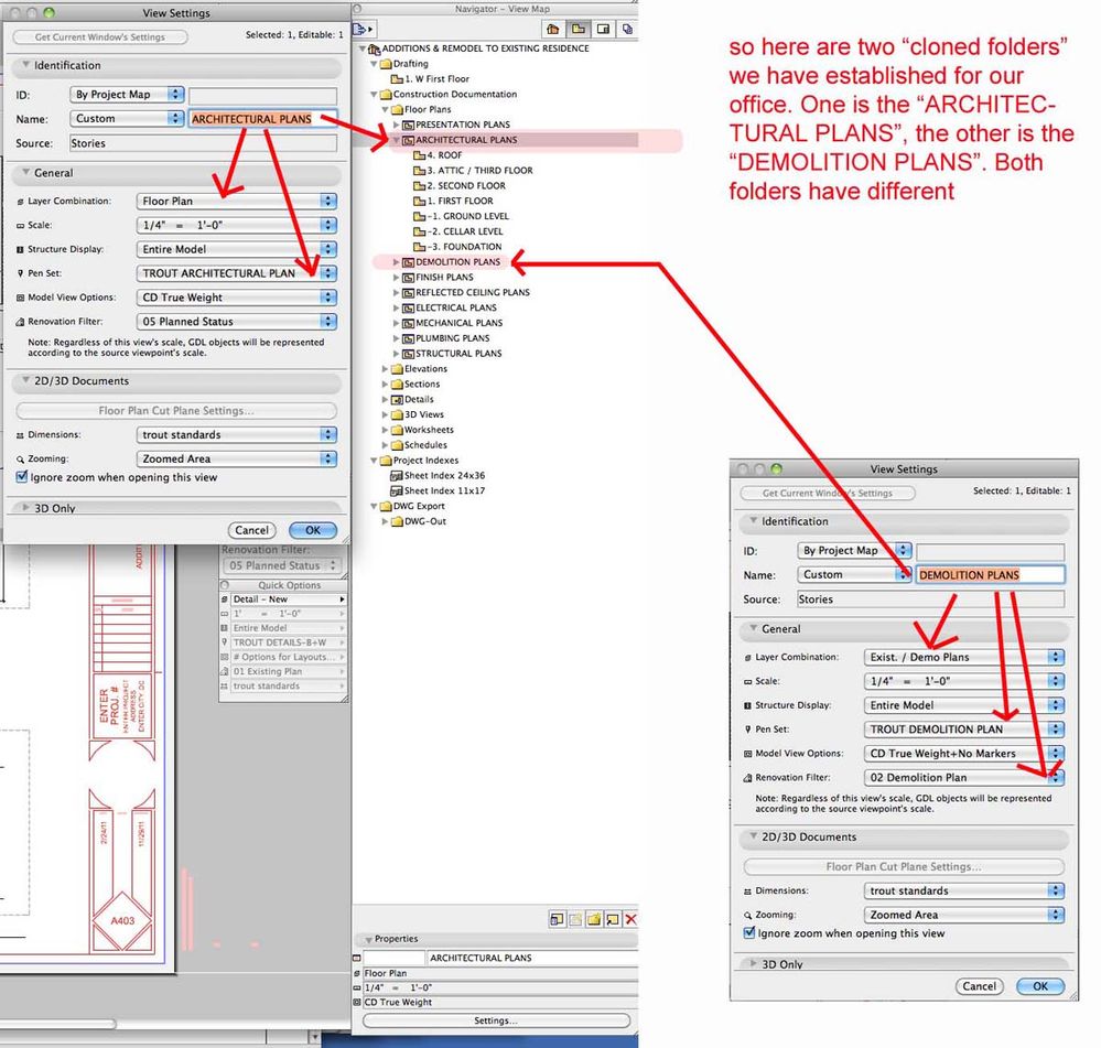

don't understand why you find the cloned folders for "PLANS" useless...that's the one in particular i'd see MOST useful. if you create another story or delete or rename or move stories..then cloned folder adjusts.
Also, you can have different "floor plans" for different deciplines...such as "Architectural Plan", "Structural Plan" , "Electrical Plans", "Plumbing plans"...etc....with each cloned folder structure having it's own Penset as well as all the other layer combo, and other settings associated to the "type" of plan you will be using.

Here's what our cloned folder structure looks like.
