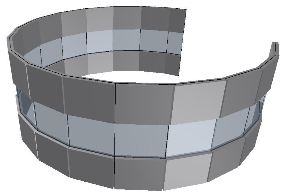

(1)I have been trying to archive culvature in the curtain wall panels as opposed to faceted, but to no success. Anyone with a solution please?
(2) Curtain walls seem to slow down the computer while working in floorplan mode almost as bad as adding a lot of landscape 3d models, is there any way to avoid this?
(3) How can I use double glazzing?
(4) How can I apply different finishing material for exterior and interior on solid panels?
(5) Is there a possibility to use composite structures as in the real world so it shows correct on sections? (AC12, WINXP SP2, INTEL CORE 2, 3.2GHZ, 2G RAM)

A current feature?/limitation? of the Curtain Wall Tool is that all panels are planar - no curved panels possible with the Tool.
Defining your own custom panel.
Make it with a simple Slab, and apply the materials you need on the upper/lower surface. Select the slab and save it (File/Library and Objects/Save custom component) as Custom CW Panel.
Maybe with a similar procedure
