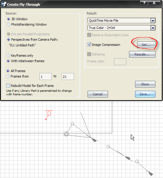

A couple of days ago I encountered a problem with the camera settings. If I place several cameras in my model to make a "fly-through", I cant edit framerate etc. When I click on the button "set" (se attached file), ArchiCAD closes without warning. This happens EVERY time i hit set. I occurs at the office (commercial license) and at the university (EDU) where I teach. All students got the same problem on 20 or so different machines. Have anybody experienced this problem? Ideas?

Most definitely I would suggest check your Quicktime installation and also your graphics card drivers....
I have seen this problem many times it is solved through one of these updates...

I've had the same problem as this. Using WinXP 64 and the latest version of Quicktime, it always does this for me. I went back to Quicktime 7.1 and all is now fine. you can download it from www.oldversion.com
