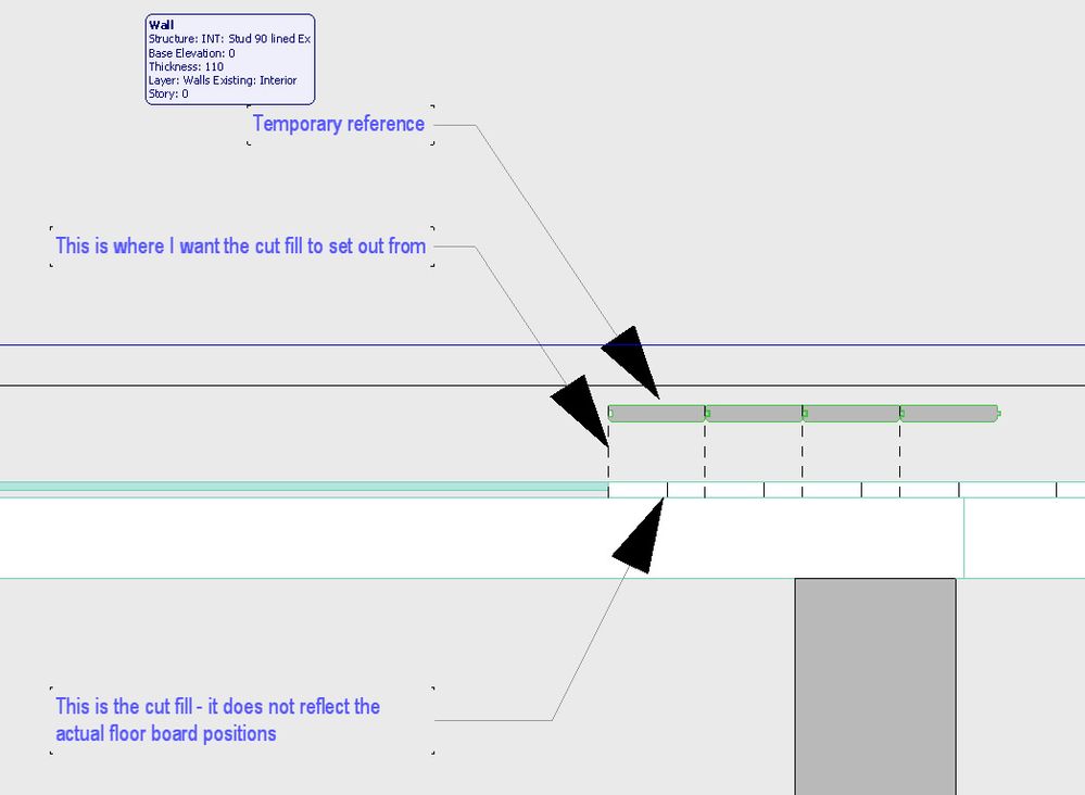

I wonder if there is a way to align a cut fill? I realize this is not normally necessary but I am using a vertical line fill type as the cut fill for my timber strip floor slab - I'd like the starting point in my sections to match the details and floor plans.
Is that clear? It would be good to be able to do it without placing a fill over the timber floor in section.

Unfortunately not mate. Cut fills orientate themselves from the Project Origin only. If you want to check, try dragging the element (or part of it) back to project origin (0,0) and see it line up. The element itself merely acts as a 'window' to the fill.

That's a shame - it would be nice wouldn't it.
A cover fill in section it is then.
