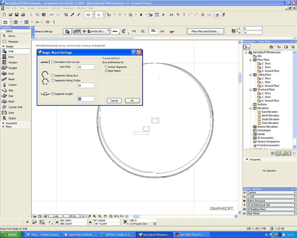

I've been trying to make a complex profile to the wall element. I've called it oval. It has a cross section that is 10 mm high and 15mm wide.
I made a handle with the polyline tool in the floorplan. That also has a cross-section of almost the same size. Then I use the magic wand to apply the wall-settings with the profile to the handle. The handle is not filled but I create some long walls. I suppose I have misunderstood the advice I got. I post the project so you can take a look if you like.
Thanks in advance.
Dwight
Adjust your magic wand settings to "best match" and try again.
Dwight Atkinson
I tried to follow your advice, but the magic wand setting was set to best match already. But there are som settings that has to do with the length and the number of segments, as I understand it. I've tried to change it, but all I obtain is big circels around the "handle". When I try to select the circle, something in the handle is also selected. My "handle" is 110mm wide and 80mm high. The cross section is 15mm wide and 10mm high.
Anne,
Draw the centreline of the handle with the line tool on plan and magic wand that. It looks like you have drawn the outline.
The oval complex profile should be centred on the origin when you set it up for this to work correctly.
Also, the magic wand settings should be set to segments along circles
and 36 segments is OK.
