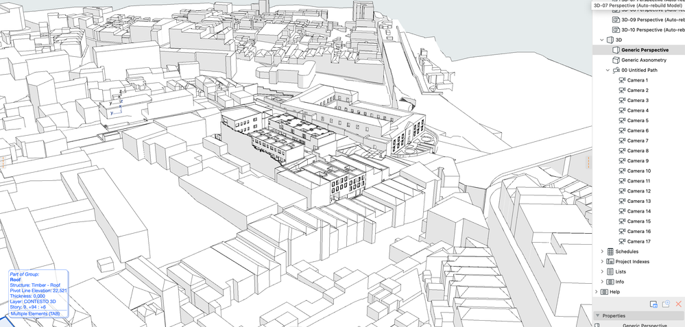

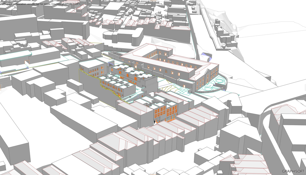

Hello everyone! I'm having an hard time with Archicad recently. I'm trying to create a long distance perspective but when I create a 3d document, for no reason it shows hidden lines inside my buildings. Of course they are alI disabled in 3d documents option. From perspective view with white model there is no problem.
Only the project part, which is more detailed has this problem, other part of the model does not (mostly made out of slabs, and 3d mesh of terrain). But if I zoom in, and create a 3d document from there the problem disappears.

Thanks, I'll attach some screenshots, with and without the problem.

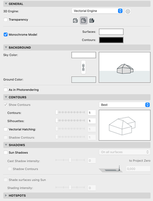

Ok, so I tried with vectorial engine, no luck. In Model View vectorial engine shows exactly the problem of hidden lines.

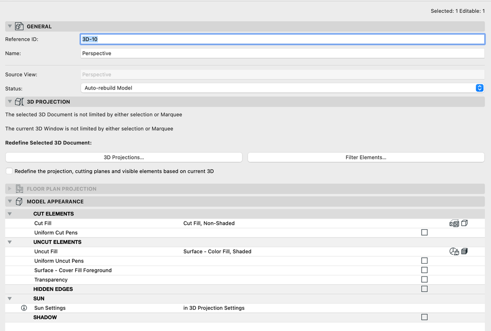

I changed a few parameters as shown here, results in model view an vectorial is ok, same problematic result in 3d document generated. Those 3d documents should be vectorial but honestly I don't find any differences.

Then I switched to hardware acceleration with white model on Model View. As always created a 3d document, no luck.
Lastly still starting from white model inside hardware acceleration option in 3d styles I checked the option to ignore hardware acceleration in 3d style. Still no luck.
As @runxel said i think that this is strange behavior of the engine, since if I zoom in those problems disappears.
