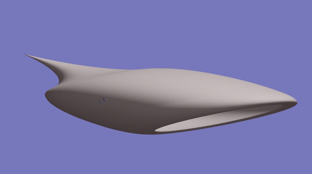

Having said you can't, I am not so sure. I am about to do it with the shell tool only I think.
Here is a quick example to show that something similar could be made with ArchiCAD only.

I think I will be able to stretch a single shell in to a similar form.

I think I could model that with ArchiCAD only.
