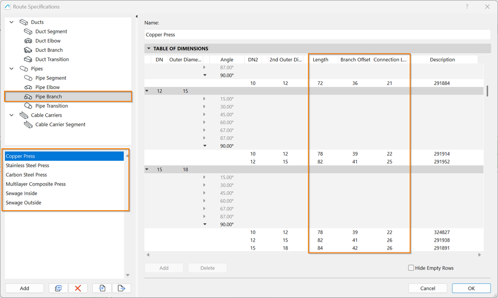

as you can see in the mep pipe route modelling. i have two elbows and a tee. tee is too long and if it intersects with elbow, pipe malfunctions, so that is why i want to decrease length of the tee connection. but i dont know how to make it possible.
i dont know whether i should change connection's setings or pipe's setings. and also changing connection's setings doesnt show any changes. please help
1 Solution
Ricardo Lopez
Hi @bimerbioboi

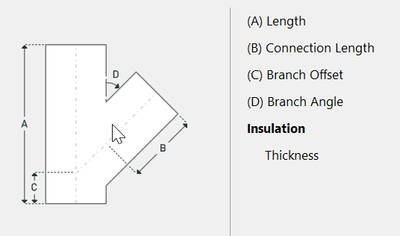

You can add or modify the settings for the Pipe Branch part of your system in the Route Specifications tool, based on the materials catalog (carbon steel, copper, etc.) and the corresponding  dimension table. The dimensions of the tee depend on the diameters of the pipe connected to it and the material.
