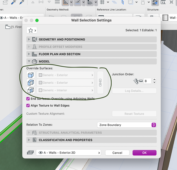

How can I change these settings that now are blocked?
thanks
I attach here a picture.

They are not "blocked" Just press the selection on the left that shows the sides of the wall. This way you wil activate the options.

See image as per Botonis's advice.
David

You would need to click on the icon on the left to activate the surface override.
It will be highlighted in blue.
