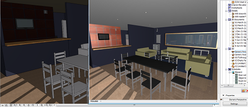

Hi everyone,
I am not sure why it is happening, but whenever I adjust just one material on a wall or slab side (such as the bottom of a slab, or reference side on a wall) each side will revert to the same material when I view it in 3D view. Strangely enough though, the settings dialog box will still indicate that each side is a different material even when I am looking directly at the problematic wall or slab. I am currently using the educational version of this software at home yet when I access my project at school I can easily adjust just one side's material with no issues.
Is there any way to fix this? Perhaps an easy work around or adjustment of an Archicad setting?

Thanks for the feedback.
Unfortunately I do have the link button unselected when this occurs, so it can't be that. However I noticed something even weirder. Whenever I take a photo render using the Lightworks engine (I took a sample and attached it to this reply), it will retain the material choices I made in the wall dialogue box, yet they will still show differently in 3D explorer.
Just so you know, I have modified alot of the materials in the material manager, so, like David said, there could be an underlying issue with textures.
That explains part of what you're seeing. There are 100% different settings (and textures), potentially, for Lightworks vs all other 3D views. The only way to make things match semi-automatically is to do your best setting up the material for the 'internal engine', and then switch to the LW materials settings and click the button "match with internal engine" ... and then fine-tune further.
If you set up your modified materials in the LW panel, then you'll have to manually edit the internal engine/opengl settings to use the same or similar texture at the same scale, etc, etc... Much more work...

Hi everyone.
Thanks for the feedback. Unfortunately there were no issues in the library loading report, so it can't be this.
I have found, however, this material issue has been deteriorating. Every time I load my project file on my home PC, more materials are missing, as demonstrated in the screenshot I took today. Yet all the materials will display fine in the photo render, with the exception of 3rd party add on objects, which stay gray. Yet whenever I load the project on my school's computers, there is no issue. [/img]
