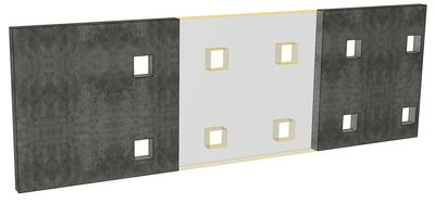

Our workflow for modeling a refurbishment project:
  1. Early Planning stage
    1. Team A is working on a concept proposal using whatever method they are the most efficient with: Rhino / Sktechup / 2D drawings in ArchiCAD
    2. At the same time Team B is modeling the existing building in a clean ArchiCAD file based off of historical documentation / surveyor data. This is the BIM model that we want to use on the long term.
  2. "Fusion" stage: Team A and B work together. Their first goal is to integrate the the proposed design in the model Team B has created. As a result of the concept, some existing elements will be partially demolished. For that, we cut those existing elements in pieces and edit the renovation status as needed.
    Left part = existing, middle part = to be demolished, right part = existing. As a result of the "cut" actions all openings are connected to all 3 wall pieces.

I took another look at this. I can confirm that if you have an Opening in a Wall, and you split the Wall, the Opening will still be linked to both pieces, even the piece the 3D body of which it no longer cuts. I will report this to GS HQ.

We've developed an Add-On based on the Archicad API to manage connections within a 3D model. This tool allows us to identify and visually check connections where no intersection is detected.
Using this Add-On, we've been able to identify numerous problematic connections and understand their origins. For one particular project, we reduced the total connections from 2300 to 1800 meaningful connections. As a result, the project's performance improved noticeably.
However, there are still some limitations:
  1. The Add-On doesn't work correctly with openings involving elements scheduled for demolition.
  2. The Archicad API lacks a function to disconnect elements directly.
  3. AND It's challenging to determine if the target element is the primary element (pinned) of an opening. Because delete the connection means delete the opening.
We've also developed a similar Add-On for managing Solid Operations. Here, identifying "problematic connections" is more challenging due to the lack of intersections between the operator and the target. To address this, we resorted to using bounding boxes, which did not always yield reliable results.
Based on our experience, I suggest that Archicad should prompt users immediately when a connection is established, asking if the connection should be maintained. Additionally, an Opening Manager/Solid Operation Manager would be beneficial for providing a comprehensive overview of these connections.
Attached are some photos illustrating our findings and the Add-On in action.
