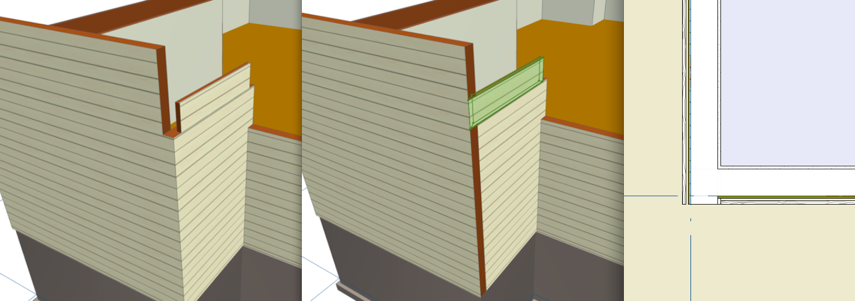

Ok, here's another one for you guys. I have two identical walls joined at an outside corner. One wall is taller than the other. On top of the shorter wall is a thinner wall that I want to join to the upper part of the taller wall. When I do this it wrecks the (previously perfect) miter of the two thicker walls. The screenshot tells the tail. The last image is the plan view of the lower junction after the thin wall has done it's damage. Ideas?

What happens if you create a Complex Wall instead of placing two walls on top of each other?
Chris Phillips
One thing you could try:
select wall either side as target object,
wall in middle as operator
select SEO addition
exicute

Yup. Know that one well, as should most people doing US residential work. I've never found a satisfactory solution to get everything to join and clean up in all views. While priorities and butt joints can address plan - they do not address section / elevation / 3D. While SEOp can address those views, they do not address plan. You're stuck making a patch at some point.
Many years ago, Graphisoft suggested that the answer was that the adjacent wall should be broken vertically... which is not a solution at all, since (1) it is not how the wall is built [not BIM] and (2), it would force you to wrap the break around the building as the clean-up would percolate - and create havoc if anything had to be adjusted. Especially on a building on an irregularly sloped site, where wall heights vary all around the perimeter (e.g., stem walls with ponies), there is no "live" solution that I know of. 😞

I was going to suggest like Karl that you can model in horizontal bands.
But as Karl also said this is not always practical.
Have a look in the OPTIONS menu > Project Preferences > Construction Elements.
Turn on the Enhancedconnections for walls and beams and see if this makes a difference.
It should help in a situation like this.
But you need to be a little more careful in how your walls (and beams) trim to each others reference lines or not.
I'll add an image in the next post to explain a little better.
This hopefully shows that you need to watch how the reference lines trim with each other (or not).
Because reference lines trim automatically you may have to go around and re-trim some walls.

I found an easier way to do what I needed, using a single wall, although it does require SEO.

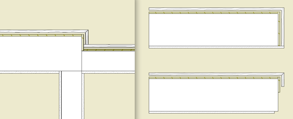

May latest conundrum involves thickened walls returning to meet thinner walls with the same outer skins. I've crocked it with a wall end, but really need one that allows each skin to be stretched. I also see the wall end is not properly recognized as a Finish element by PSD, nor does it appear to pick up the skin priority from the composite.
The left shot shows what I want, although ideally the lines at the core should not be there since the fills are the same. On the right is the wall end that I used (top) and my fantasy wall end (bottom). I'm not sure if a wall end can be scripted to do that.
