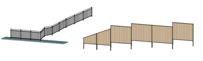

Hi there, has anyone in Australia successfully created colorbond fencing with an edit of a preset railing ? I don’t need a high level of detail except to show the metal sheet profile in the panel settings. How do I get a colorbond panel to show up in my railing panel setting ? A standard Bunnings fence kit with inserts is what I am trying to model up.
I do have “CI tools Coverings” installed so I might just draw a standard railing with a few edits and just clad the rail or even draw a wall and just add the colorbond profile to it ? If you have a better method please reply.
Please see the PDF below for a picture of what I am trying to model.
Thank you.

Yes that’s fine, segmented railing is not a problem if the site was sloping.
If you could somehow disconnect a stair railing and use that without the stairs, you would think that would follow an incline or that is should be scripted to do so ?
A future incline railing tool created from a stair slope maybe possible in the future and that can also have substitutable panels placed in it as well.

Not sure I understand.
A single railing can follow any incline already.
It doesn't have to be a stair.
In fact you can just grab (create if need be) a node on the reference line and drag it vertically in 3D or elevation.
It doesn't even have to associate to any other element.
It is just the segments will rake and not step vertically.
The issue is that your custom panel will not slope with the rest of the railing without proper scripting, so you would have to model a panel for each inclination.

That information is all very helpful. So if I want a stepped fence, I just have to use railing in segments.

So the custom panel will not rake if the railing rakes and the top & bottom rails can not be horizontal if the railing rakes.

You could create a single panel as a parametric param-o object, with end posts whose visibility can be toggled on and off, but then you would have to copy/array the object for every single panel and group them.
It would show in 2D and 3D and should work correctly - it would just be a pain to edit.

You can do something like this using custom balusters, where you model each complete repetitive profile unit like this:
This creates a fence like this:, which even copes with gradients.
The custom baluster profiles (just like fence panels, posts etc) do not display correctly in 2d though. This is a limitation which I've put on the wishlist.
