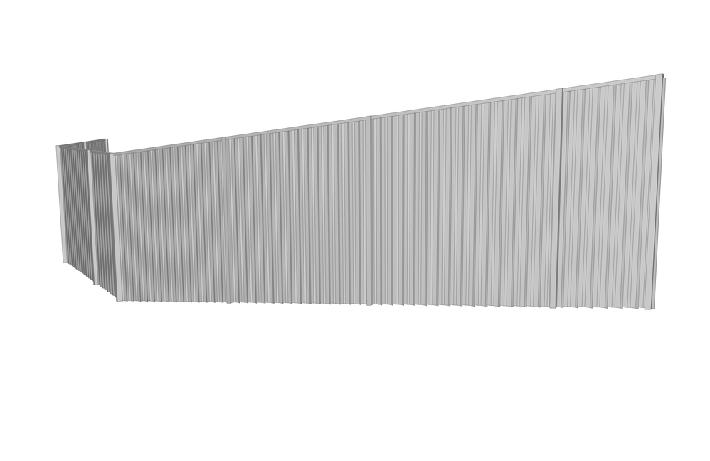

That is why I created my own GDL object.
Sorry I can't share being company IP.
Not sure if there are any fence objects in default library now, or they may have all been removed now the railing is there.
If you have an old version pre railing tool (20 I think), there may be some fence objects.
Or there could be some in BIMComponents if you search in the object settings.
Or maybe Param-o could help create an object without the need for GDL.
Still would be a bit of a learning curve.

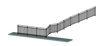

You can do something like this using custom balusters, where you model each complete repetitive profile unit like this:
This creates a fence like this:, which even copes with gradients.
The custom baluster profiles (just like fence panels, posts etc) do not display correctly in 2d though. This is a limitation which I've put on the wishlist.
