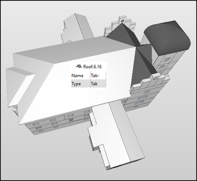

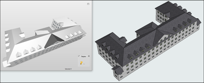

I have a building that, when exported to IFC, the roof changes colour. But not to all planes (See picture)
Rightmost picture is from AC25 3D-view, leftmost is from Solibri. How come all but one have changed color?
All the planes are based on the same "setup"

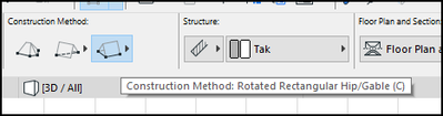

I am guessing the large Roof is created using the Multi-plane geometry method, while those two gray Roof elements were done using the Single-plane geometry method. That could be a difference and that may somehow affect the IFC output.
The roof  that differs in color is made using this method:
And it is the same tool I've used on both sides. But it is only one of them that is acting up....

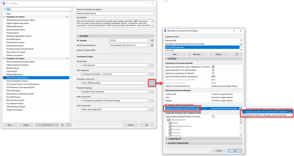

Just checking if setting this field to either of the two "Explode" options makes any difference in this situation. See image.
This field applies only to IFC2x3.
I will look into that option!
Thank you.
