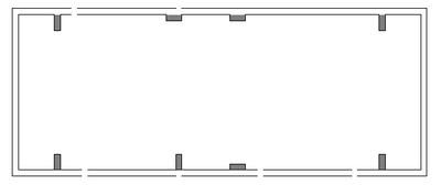

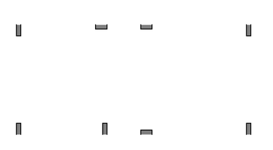

So i am modelling a residence..now i ahev such condition in basement where theres a RCC shear wall on perimeter with columns jutting out..now when viewing individually and preparing for soem drawings they dont show full border...Any solution to this? as it looks oka when seing together.
same happens in otherplaces for other junctions...Help needed ASAP (deadline 😞   )

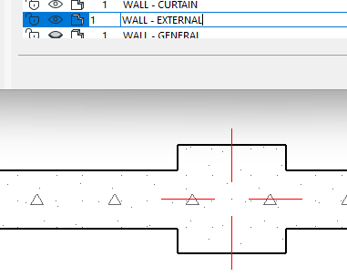

Change the Intersection Group between your Layer Combinations so that when you just want your columns, the walls do not intersect with them and vice-versa.

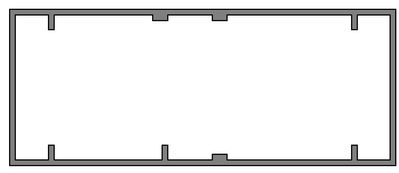

Both visible, same Intersection Group

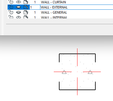

Wall invisible, same Intersection Group
Wall invisible, different Intersection Group
