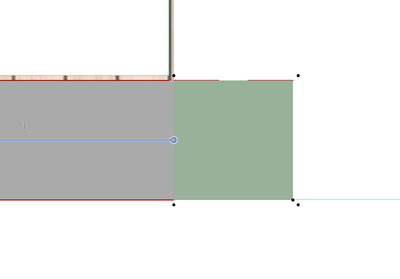

Hi all,
Other than maybe modelling the core and skin seperately, is there some way to get a consistent edge representation between a Complex Profile Column and a Composite Wall when applying a No Skin Separaters GO to a Core Only plan? GOs seem to ignore Partial Structure Display... I already have two CP columns here...
Ling.

The issue is that I have a GO that is set to "No Skin Seperators" as I do not want to see any of the cavity lines for this drawing, and this setting is getting applied before the Finishes are removed resulting in the CP Column having no outline when using the Core Only PSD.
Ling.
