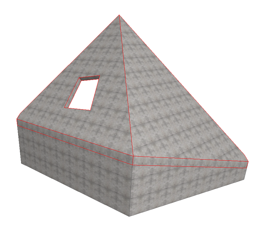

I have a model I did for my firm in Luxembourg in Autocad which was fairly complicated, and I would like to redo this in ArchiCAD as a learning process.
My first problem are the non-rectangular walls, for instance the front wall. How to create this in ArchiCAD? Is it possible with the wall tool, or do I have to use another tool to create it? Or solid element operations?

I would use Walls for the vertical walls.
I would probably use the Roof Tool for the sloping parts.
You could cut the holes for the Windows into the Roof with the Roof tool.
Then you could use the Curtain Wall Tool to create the Windows that go into those holes. Curtain Walls are good for this because you can create any polygonal shape and you can rotate it in 3D any way you like.
The Wall-Roof intersections can be done perfectly using Trim to Roof, or Solid Element Operation, which I like even more since it is an associative relationship.
Here is what I mean.
The Walls are Walls, the sloped elements with the red outline are made of Roofs.
There is a hole in the Roof.
The Walls are high enough so that the bodies of Wall and roof intersect.
I used Solid Element Operation (Subtraction with Upwards Extrusion) to cut the Walls with the Roofs.
Then I created the Roof window out of a Curtain Wall.
The original Curtain Wall I did was laying horizontal. I then rotated it to the slope of the Roof. Put it in its place and then moved the nodes to match the nodes of the Roof hole.
