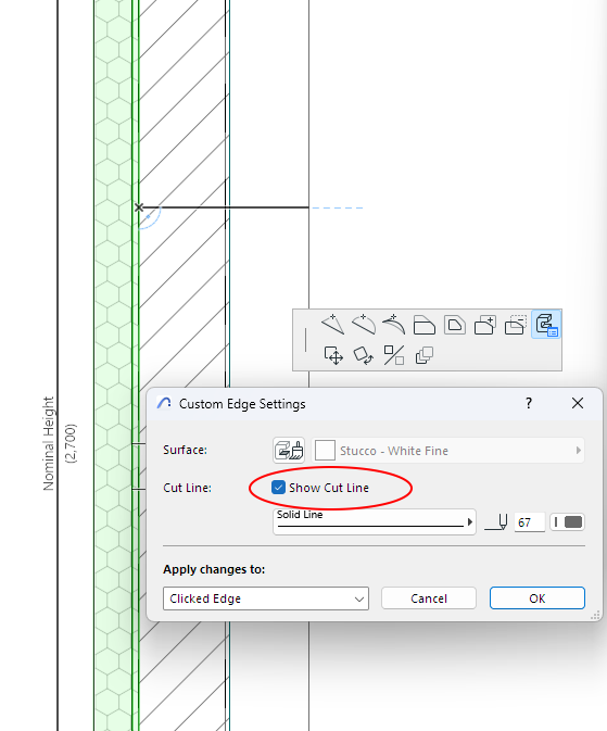

Hello,
I have problem with lineweight of complex profiles on floor plans.
The lineweights look correct in the profile manager and in section but not in floor plan. I tried to set draw order but its not helping.
True lineweight is on. Any advice? I attached screenshots.

In profile editor select your insulation fill. From there you can click on the fill's line facing brick. A popup appears, click the "Custom Edge Settings" button and turn the line off by unchecking "Show Cut Line".
That should do the trick.

That worked, thank you!
