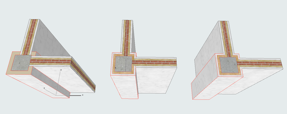

not solved, independant wall or intersected, the profile wont continue on column ( wrap method ). Here is the screenshot
Ok, after I could reproduce that case,
I can find the problem in rectangular wrapped columns appearance in 3D View when placed inside composite walls despite 2D floorplan appearance is perfect.

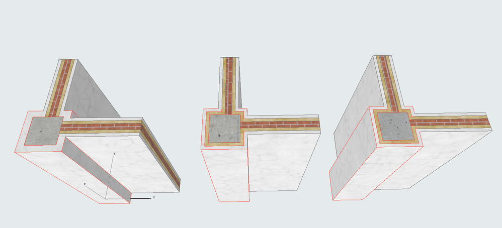

  • When physically based rendering is ON.
  • When physically based rendering is OFF.
  • Even exist in Ver. 25.

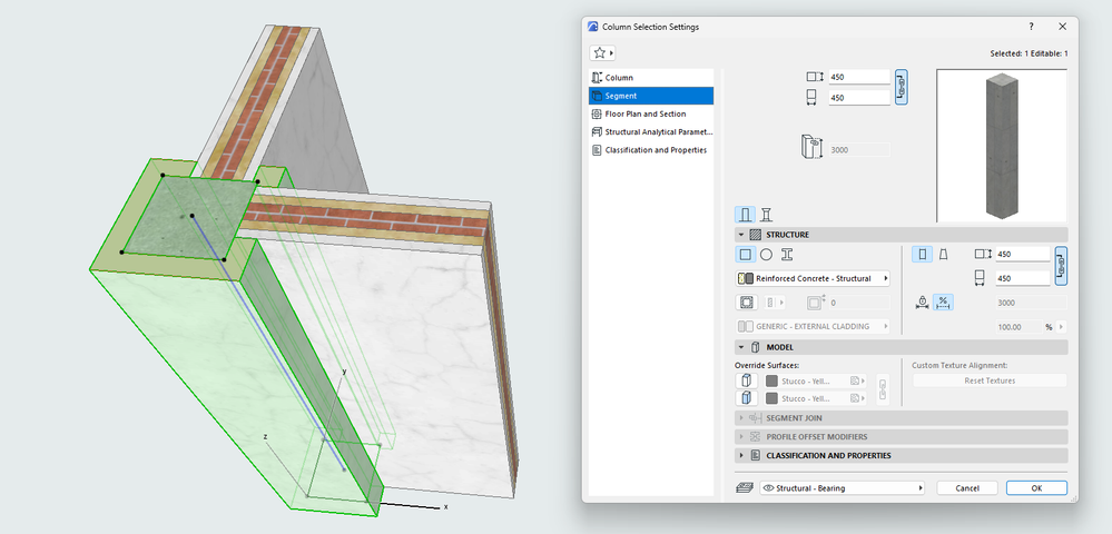

  • I noticed the problem is in the column veneer's surface material which is applied to the top end surface despite inactive veneer as in these two case
the 1st has Stone BM and the 2nd has Generic - external cladding.

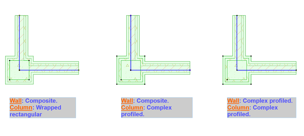

  • I can't approve it's a bug or a trick in Archicad which i should know,
but for now, as illustrated above you should use a complex profile column with the composite wall for a better 3D appearance.

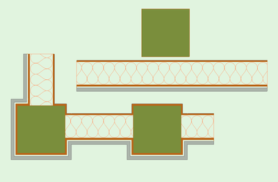

For sure, it should be considered as a bug, what else ? Since a material is classified as finishing on composite, it should wrap around the core of the column, now, it work only with one finishing material, more than one ( for exemple plaster + tile ) , it doesnt work in 3 D. Doesn't make any sense to have composite, column wrapping method but still have to make a profile for the column.
I think this is actually as intended.
It does not say explicitly in the HELP reference that the finish/other skins will wrap in 3D.
It does say the thickness of the column will be increased and that the external surface material of the wall will be carried around the column.
Which is what happens.
