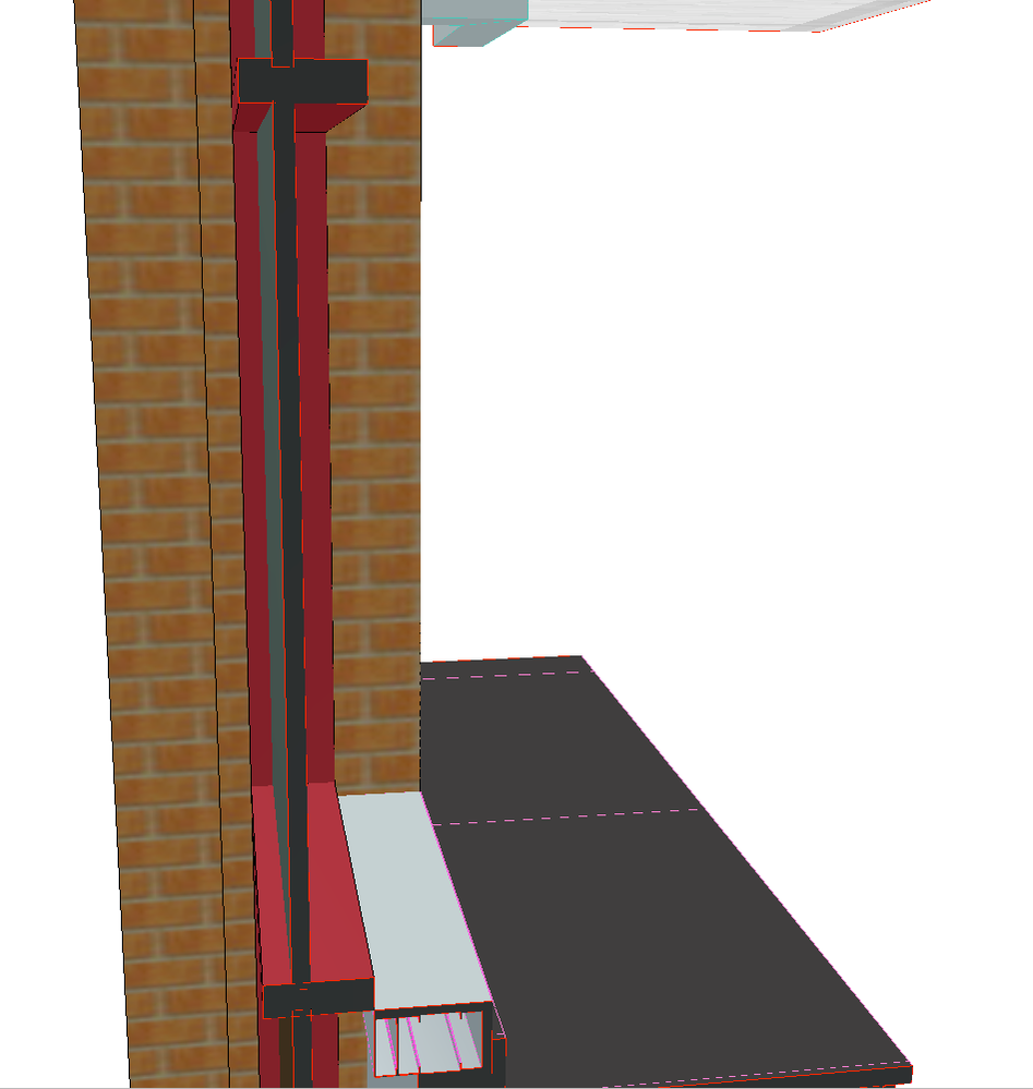

Is there a way for you to give each skin their own material when using a composite wall?
In the wall selection settings under model there only seems to be 3 options.
Outside of reference line material, end wall material and opposite of reference line material.
Please see attached screen shot. I am trying to get the brick just to show on the outside. I have used the curtain wall tool for my window and can't add a casing.
Any ideas?
1 Reply 1
That is it unfortunately.
Some window and door objects are (or can be) scripted to add reveal to the side to match the internal and external material of the wall.
I am not sure about the standard windows and doors as I don't use them.
I don't know if curtain walls could be scripted to do the same.
