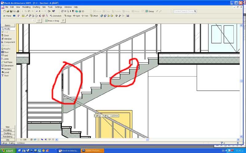

why archicad don't split material in the section of stair see the pic and comparee between elevation an section

look how revit 2009 do it
this is a very painful question.... i have no idea why.
this question was ask many many many many times here on this forum without any real solution, i choose the hard way and i overlap some fills... this is it.

Stairs in ArchiCAD have always been a very weak element. Two third parties sell add-ons that create very flexible, powerful stairs and railings. Cadimage has Stair Builder, and Cigraph has ArchiStair 2.
The attached screenshot shows where you can control the fills in ArchiStair 2 and the result.

thank karl I always see you in my question thank you but I hope if archicad do that alone because we but the material for every part in stair
and we see that in elevation may be I will put in my wish
thank you again ...... nour

just model your stairs.
None of those stair tools are any good.
With a little effort and can I use Objective make railing and stairs with the best composition
