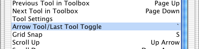

I'm trying to get used to 8.1, and there seem to be some great improvements, but there are a couple of issues I need help with. I'm used to removing a marquee by doing a right click, (Windows) and pressing 'Q'. This doesn't work with 8.1, and I can't figure out how to set it up in the Keyboard Shortcuts dialog box. The same goes for the Multiply command. What am I missing?

rocorona wrote:
Now the tools can be activated with keyboard shortcuts, but I miss the "back to previous tool" function that was provided by the right arrow.
This shortcut is still there, it just doesn't have a key assigned to it by default. It's under the Actions list in keyboard shortcuts (see attachment). I've got mine assigned to the ` or ~ key at the top left of my keyboard for quick access, although I must admit I'm still getting used to it.
Lee wrote:
...but I've discovered that only numbers, punctuation mark and symbol keys work without a "modificator" key. Assigning a letter key by itself doesn't seem to do anything. Am I missing a setting, or is my keyboard not set up right?
You need a modifier key for the Menu Command shortcuts, but not for the Actions or Tools shortcuts. Take a look at the default ArchiCAD 8.1 scheme from the pull down list, it has many functions using letters only. Did you start from this scheme? Are you sure your not applying the same key to two functions?

In order to have a consistent working method between AC7 and AC8. Is there a way in AC7 to assign the Arrow Tool/ Last Tool Toggle to a key other than the Right arrow?

Richard wrote:
For the filled-in "o", try different settings under Preferences, 2D Redraw options to see which works the best. HTH,
... also try to switch the 2D OpenGL off, or tweak the settings?
