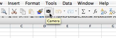

problem we have ran into with pasting and live linking is that only allows 45 rows...it's very limited...where is the excel camera tool.....
__archiben
i've no idea where it's originally found, but i've put it out in my toolbar for easy access . . .
just select the cells you want to 'copy' and then click the camera tool. in archiCAD (or more typically a layout) 'paste' and choose 'as drawing elements'. the text comes in as text and any cell borders are retained as lines.
as i said - it's not live, but it's a pretty quick and easy way of grabbing a chunk of excel data and placing - wysiwyg - in a layout book. especially for non-OLE mac users!
