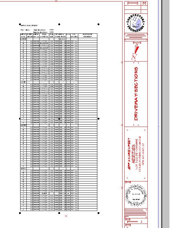

Yes I have been using CTRL C (copy) and I have tried OLE.....but for what ever reasons I get cut off at the 45-50 rows....any clues....
Just did a quick test and I was able to OLE a Sheet with 83 Rows (row Height set to 15).
I am back on MS Excel 97 SR-2.

I gave it a run in Plotmaker to Excel...and only get 45 rows....just to let you know...I am using 2003....anyone using 03 give it a try for me and see if you get the same results
