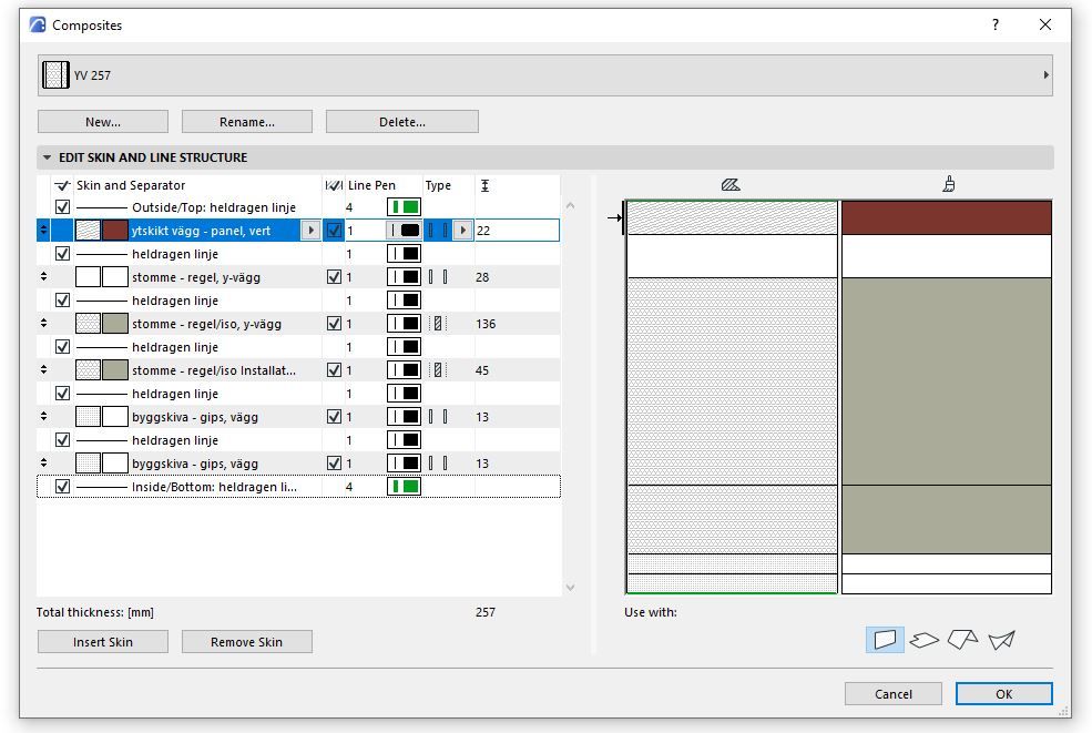

I´m having a problem copying walls between levels. When I copy and paste a wall on to new level the paste walls becomes 2d (Lines and Fills).
I can copy past on the same level with no problems or in between diferente Archicad projects, but not in the same file.
This is happening only on custom composite walls I created personally. If I use a composite wall that came with Archicad it works fine.
I´m Working on Archicad 25.

Perhaps you could share a screen grab of your "Custom Composite Wall" settings?
AGaspar
I´m using the wall layers that come standard with Archicad. It´s Archicad 25 SWE (Swidish)

Solution
AGaspar
Sorry for the late reply, but finally I figured it out what the problem was.
I have a program for translation text (Qtranslate) that was messing out with the shortcuts of Archicad.
 Thank you all anyway.
