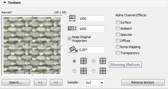

Now I only have one question left regarding this matter.
The dimensions of the texture in the Internal engine ( Attachment), how do I set it in the master_GDL_mymaterials.gdl file?
Extract from master_GDL_mymaterials.gdl:

Preview image of the texture has no effect. Just consider the size of original texture. Avoid big textures if possible.
You can resize it with x, y dimensions (keep current proportions). Save as a new Master_gdl.gdl file, and AC will update the texture definition.

I had forgot that this dimensions didn't have any effect.
So then I don't need to care about them.
Now I know the whole process to make new materials that I use in my objects, in an effective way.
